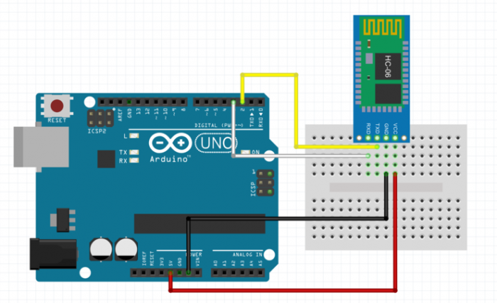

배선도
d99b7e08ff76cb2f9b8918929d91a0ba_1478695
VCC - 5V
GND - GND
TX - 2
RX - 3
